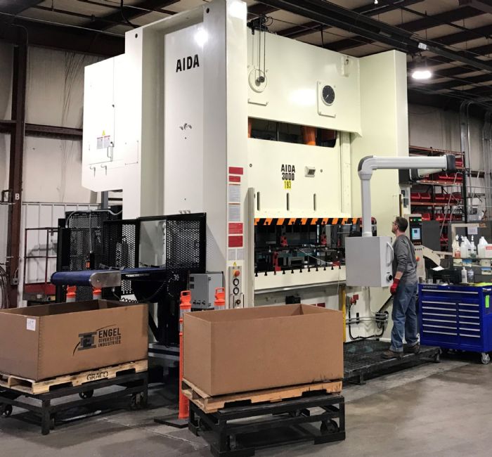

Working with its distributor and integrator, TCR Integrated Stamping Solutions (Wisconsin Rapids, WI), the Engel management team crunched the numbers and, based on overall system cost, it became easy to justify the additional purchase price of a servo press. TCR owner Todd Wenzel worked with Rubin to develop a completely new, top-end stamping line comprising not only the press, but a beefed up 10,000-lb.-capacity servo-based Coe Press coil-feed line; state-of-the-art press controls from Link Systems, with tonnage monitoring and signature analysis; a custom scrap-handling system; and ANSI- and OSHA-compliant guarding, “which requires absolutely no input from the press operator,” says Wenzel, “an important feature to ensure safe operating conditions at all times.”
A Workhorse Press
Installed and running in August 2019, the new press has taken over several dies previously run on the firm’s traditional 300-ton mechanical presses, and has returned significant benefits in terms of throughput, quality and overall performance. “We’re running faster (pendulum mode), improving dimensional accuracy (stroke control, including dwell at bottom) and improving die life between sharpening (less reverse tonnage),” says Handzel.

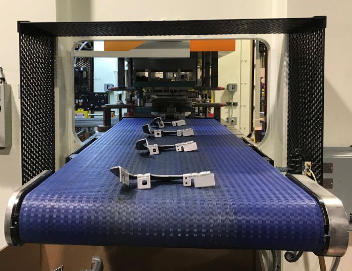

Engel runs the bracket in the pendulum mode, resulting in more than double the stroke rate compared to running it on the conventional press.
“In addition to added speed, another key factor contributing to the ROI of the press and its ancillary equipment,” adds Rubin, “as illustrated with this particular part: minimum reverse tonnage, since we can slow the ram just prior to breakthrough, which benefits tool life. We can run two to three times more parts than we used to before we have to perform maintenance on the tool, and we see this benefit on other tools run on the new press as well. Further, we used to suffer an inordinate amount of broken punches on this tool, a problem nearly eliminated now.”
All of this adds up to a remarkable improvement in overall run rate on the bracket—from 488 parts/hr. before to 1000 parts/hr. now. Of course, along with such an increase in run rate comes challenges in parts and scrap handling. Here, Engel, with Wenzel’s help, engineered a process to automatically stop and start the conveyors with a signal from the press. “Everything is managed from one central control pendant,” says Rubin, “including the coil line.”
