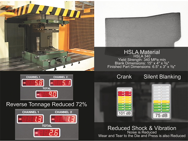

4) Lower Maintenance Costs
The ability to control slide velocity during the working portion of the press stroke enables stampers to reduce the shock and vibration associated with metalforming operations. Lowering punch velocity during forming also significantly reduces heat generation, with a corresponding improvement in die life.

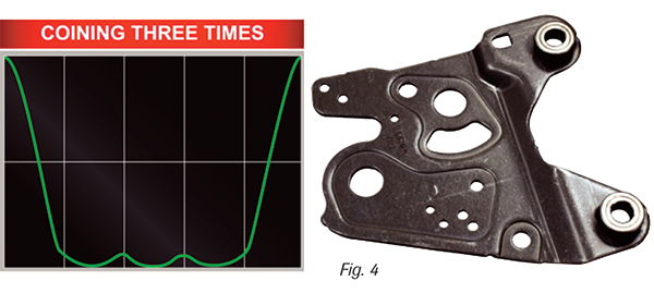

The ability to program slide motion and incorporate secondary operations into the initial press operation has provided many servo-press users with significant savings. In-die assembly, tapping and welding become much more practical in a servo-driven press because the time required for these operations can be programmed into every press cycle.
Stampers also can eliminate in-process annealing operations with a servo press, due to the precise velocity programs used to form high-strength steels or exotic materials such as magnesium and titanium alloys, Inconel alloys and even some grades of high-strength aluminum. Often, reducing the forming velocity reduces the heating of the material being worked, which limits work hardening and improves formability. However, in other cases the addition of heating elements in the die and a programmed dwell in the press cycle enables the warming of the material being formed, which can significantly improve formability.

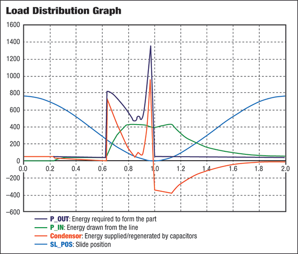

6) Reduced Energy Consumption
In the accompanying servo-press load-distribution graph (Fig. 7), the heavy blue line represents press slide position and the thin blue line represents the energy required to form the part. The green line shows the energy drawn from the factory’s main power line; the remaining energy consumed comes from capacitors recharged during the nonworking portion of the press cycle. In this example, peak load on the factory main line is reduced by 67 percent. This compared to a standard mechanical press which continues to draw a large amount of power during the nonworking portion of the cycle, since the main motor works hard to bring the flywheel back up to speed between hits.

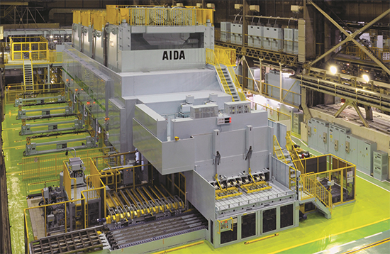

We’ve taken our time and completed our investigation of servo-driven press technology, and have reached a conclusion. Every stamping operation is different and not every metalforming job will run better in a servo press. But, the vast majority will. The servo press has the flexibility to address nearly all problem areas found during metalforming. A testimony to this is the number of servo-press users that buy a second or third press, after gaining experience with their first machine.
We see servo-press technology as the wave of the present and the near future, and believe that those who jump on will have a leg up in the metalforming arena. We’re going to make the move. MFView Glossary of Metalforming Terms
