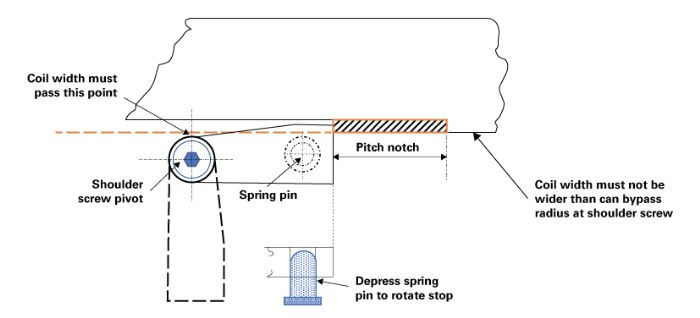

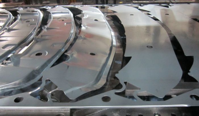

A pitch notch or pitch stop can provide a physical point from which to locate and control the leading edge of the strip. Stampers can mount the pitch stop on a pivot and monitor it with a sensor to prevent the press from operating with either a short or long feed. In some cases, the stamper can replace a pitch notch with an edge-form or lance-form operation. Here, the bent material stiffens the carrier to allow for smoother feeding (Fig. 2). If desired, the bent edge can be encapsulated in a modified guide rail to prevent edge bending or buckling in dies with long pitch lengths.
Fig. 2Coil changes require removing the remaining strip from the die by pulling it through the exit end of the die, or by backing it out of the entry side. The combination of formed features and a pitch notch in the strip may prevent strip removal.  In these cases, the operator will need to cut the strip into two pieces and remove them from opposite sides of the die, which can be time-consuming and usually requires hands to be within (or close to) the point of operation. In some cases, a rotating pitch stop (Fig. 3) can facilitate removal of the strip in one piece through the exit side of the die without the need to cut the strip.
