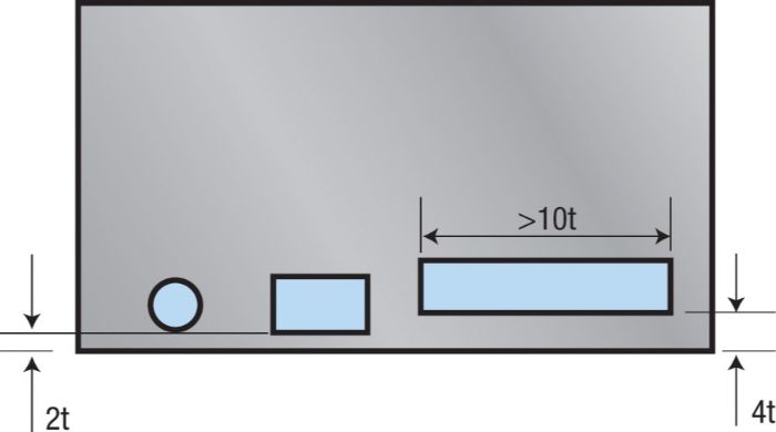

Fig. 1Punch holes located close to the edge of a blank prior to blanking. The minimum distance of the punched hole to the blank edge should be no less than two times material thickness. Slot features greater than 10 times material thickness in length require a minimum distance to the blank edge of four times material thickness (Fig. 1).

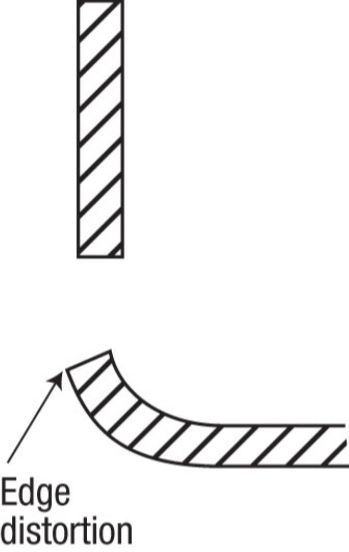

Fig. 2Slot-to-form spacing for long slots should be at least four times material thickness plus the bending radius to prevent the slot edge from distorting (Fig. 2). If additional holes are required, punch the holes first, form the flange and then punch the slots.
