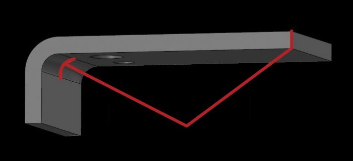

Bend radii, forming limits: Avoiding overly sharp bends is essential to preventing cracking and excessive stress on the die. A rule of thumb: Design bend radii that are at least equal to the material thickness.

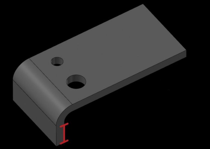

Bend leg: Avoid designing bends with a short leg length. The bend height, measured from the tangency point of the form radius, should be at least 2.5 times the material thickness.

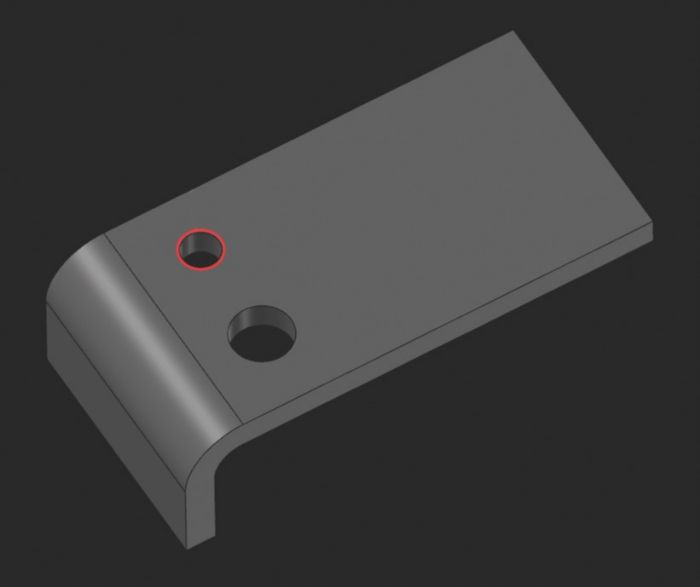

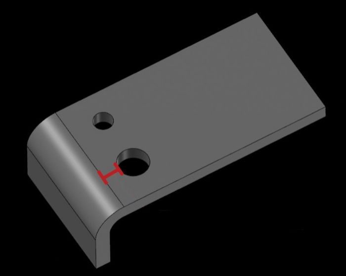

Hole, slot sizing and placement: Holes located too closely to bends, edges or other holes can become distorted. Best practice: Place holes at least 1.5 times the material thickness away from bends, edges and other holes to prevent tearing or deformation. Ideally, the holes and slots should have a diameter that is equal to, or greater than, the material thickness being punched.

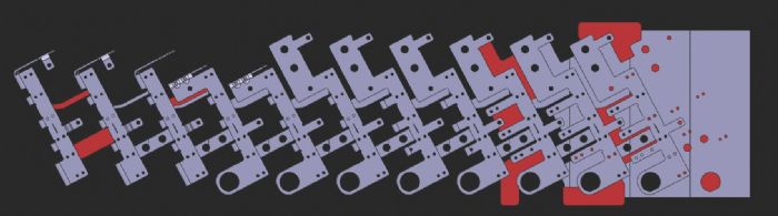

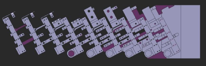

Proper use of progressive and transfer dies: Understanding whether a part will be made using a progressive die (ideal for high-volume production) or a transfer die (for more complex, lower-volume parts) can significantly influence design choices.
