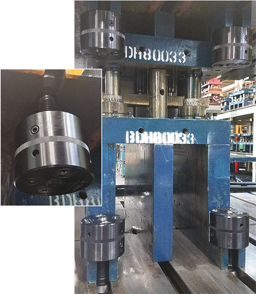

The Hilma hydromechanical clamping nuts shown here on this Aida 330T press at Northern Stamping are manually placed on the clamping edge of the dies and easily tightened with a few turns of an Allen wrench. The dies are clamped by applying hydraulic pressure to the clamping nut's internal piston. This preloads the T-bolts, securing the die the press ram or bed, enabling safe and simple die changes. |

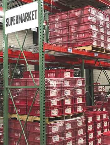

- Reorganized the warehouse to ensure efficient packing and flow of parts, allowing for more work by fewer employees—from 10 to four—and freeing employees for other tasks.

NSI’s newly organized warehouse, a.k.a. the Supermarket, includes coded bins of certified, ready-to-ship finished production parts. |

Another missing component of the past now in place to aid NSI’s transformation: quick-die-change equipment. NSI’s newer 1650-ton Aida servo press, now equipped with customized hydraulic clamping systems from Hilma USA, led to the inclusion of Hilma hollow-piston cylinders from Carr Lane Roemheld Mfg. Co., Fenton, MO, on nine NSI mechanical presses and one 330-ton Aida servo press.
“Steve Amell, Carr Lane’s regional sales manager, worked with us to put together the manifolds on the 1650-ton press,” says Nathan Gottlieb, NSI process engineer and project coordinator. “This included the tubing, gauges—the whole hydraulic system. Then he pretty much pulled out of his back pocket, another type of clamp, a hydromechanical clamping nut. It was like a hollow-piston cylinder with no tubes, because the pressure is internal. We were amazed at the possibilities these presented.”
Here is how these clamps work: The clamping nut, is placed in the U slot of the die then tightened with an Allen wrench. This applies pressure to an internal piston, preloading the T bolt and clamping the die, when pressurized, a pin extends indicating that it is safely clamped. It's that simple.
