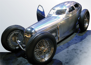

In 2007, Dan Webb set out to honor Miller’s iconic creation by building a low-sloping hotrod variation of the original. For Webb, the project needed to transcend mere steel and rubber and embrace the spirit of Miller’s obsession with quality. What Webb brought to the project 90 years later was a new level of welding technology available only in the last few years.

Webb considered the V310’s technology capabilities to be a substantial breakthrough, and so with the original builder in mind, he decided to lay down perfect GTA-weld beads throughout his Golden Submarine replica, regardless of the need for visibility—just as Harry Miller would have done.
“Sure, there’s parts in there nobody sees, but I know they’re there,” Webb says. “When you leave a perfect stacked-dime weld on every joint, you know the car is done right, and that’s something Harry Miller would have done.”
Attention to detail? Webb deposited welds on similar parts at exactly the same length; identical welds repeated on opposite sides of the car have the same number of ripples; and each ripple is spaced equally apart. On brackets, for instance, with two parallel welds, identical stacked-dime patterns are laid down on the first side and then back up the second side, creating mirror images of each other.
To ensure similar weld sizes throughout, Webb used a center punch to mark the base metal at weld start and end points. He then counted the number of times he dabbed the consumable weld rod into the molten puddle, precisely timing intervals and travel speeds. His ultimate goal was for weld continuity throughout the entire car.

The original Golden Sub’s notable golden hue came from a combination of lacquer and bronze dust. Webb’s modern tribute car, on the other hand, features a hand-formed, unpainted raw-steel body that purposely exposes the builder’s workmanship. Webb says he will never paint the car.
Steering, shifting and pedal controls on Webb’s car are all hand-formed in steel. It sports a 2.0- l Ford Zetec four-cylinder engine with mounted disc brakes borrowed from a motorcycle. The torque tube passes between the driver’s legs, and the exhaust is channeled through wrapped pipes down the drive’s left side, exiting through the rear tail tip of the teardrop body.
