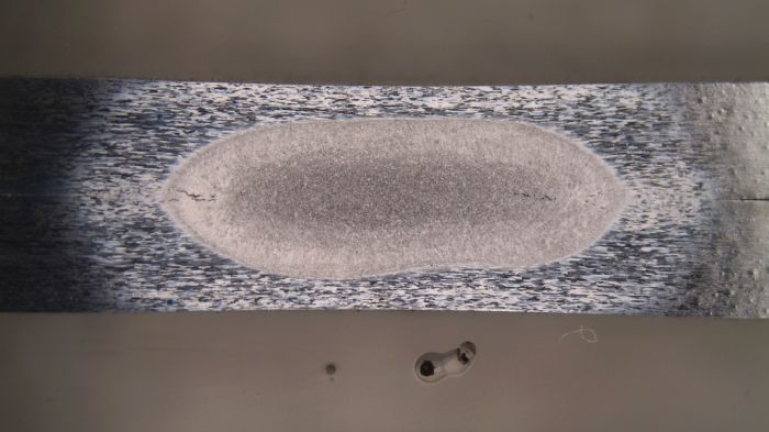

Shunting affects the size and consistency of consecutive welds and occurs when placing welds closely together. As a result, part of the current is diverted through the path created from the existing weld, which causes a reduction of current, and thus heat, at the site of the weld being produced. The result: an undersized weld.
resistance weld etch aluminum lithiumThe buildup of surface contamination from oxidation on steels, aluminum and nickel alloys generally increases the resistance of the workpiece material and can have detrimental effects on the welding process if not appropriately addressed. When this type of variability occurs, the use of conventional controls to regulate current can create more process variability than when no weld-current regulation is used. Why? The regulating action of the control becomes the reason for generating excessive heat, so rather than reducing variability, the regulating action of the control overheats the part, potentially resulting in expulsion of molten material and electrode damage.
Also, poor fitup—such as when a workpiece is bowed or otherwise warped—can cause the weld current to not flow properly through the components, which can result in no weld, an undersized weld, and expulsion.

Traditionally, periodic destructive testing has been the primary method of evaluating weld quality. Destructive tests can identify if a change has occurred in the welding-machine setup. However, because each weld cannot be subjected to destructive scrutiny, unacceptable welds may escape detection. Such tests will not address or correct the root causes of undersized welds, excessive heating, expulsion or material-surface contamination. In addition, poor-quality welds can occur randomly. And, destructive tests also can be costly and time consuming.

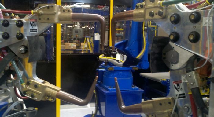

Adaptive Controls to the Rescue
To address the wide range of workpiece variations more effectively, shops must be able to monitor multiple process variables simultaneously, and instantly react to counteract the effect of the variations. This is readily achieved with properly equipped adaptive RW-process controls. Such controls automatically adjust to the conditions of each weld by detecting unwanted conditions, employing the appropriate decision-making process, and then taking appropriate action to correct and/or compensate for the conditions as each weld is produced. Adaptive control improves the consistency of all welds produced and reduces the incidence of problem welds. When a problem is so severe it cannot be corrected, the adaptive control notifies the operation and produces a record of the condition.
Adaptive controls, for example, can detect variations in material coating and surface resistance, and then take the appropriate corrective action. In the case of a higher-than-normal workpiece resistance (indicating surface contamination), the control immediately reduces the amount of heat input—just enough to burn off the surface contamination in a controlled fashion. When the contamination has been reduced to acceptable levels, the welding process completes to its original specifications.
The same adaptive control can address poor fitup issues as well, by reducing heat input to soften the parts just enough to get them to fit flush together before increasing the heat to complete the weld.
Adaptive controls also can compensate for shunt conditions and flattening of the electrodes. As the weld forms, if the control detects a lower-than-normal rate of thermal expansion, it will automatically increase the amount of weld heat to compensate.
