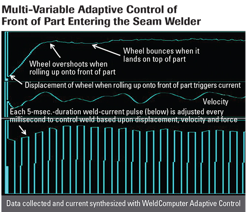

Front end of part: Adaptive seam welding at 22.5 in./sec.
Selecting a control with a high-enough operating-current limit, such that current is not the limiting factor in determining how fast welding can occur, ensures that the adaptive control runs the machine at maximum speed while maintaining weld-consistency standards.

Another challenge: As the speed of a seam welder increases, so does electrode-force variation, a source of weld variation. As the seam wheels roll up onto the front of the part at high speeds, the wheels often overshoot and bounce onto the part. The momentary higher electrode force caused by the bounce can translate into an undersized weld, causing a leak. Depending on the resonant characteristics of the electrode-force system, the step of the wheels rolling up onto the part can excite a machine resonance, which could take several oscillation cycles to subside. Each of these oscillation cycles can translate into a weld that is too cold as the wheel bounces down on the part, followed by a weld that is too hot as the wheel bounces off of the part.

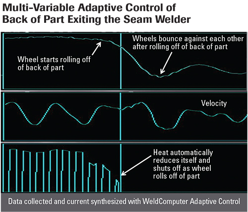

Back end of part: Adaptive seam welding at 22.5 in./sec.
The solutions for both these challenges: an adaptive control that can be installed on any seam welding machine. For weld-velocity fluctuations, an adaptive control can adjust the heat up and down in response to instantaneous wheel-velocity fluctuations, resulting in fewer weld variations. The same is true for electrode-force fluctuations; the adaptive control automatically adjusts the heat up and down in response to force fluctuations.
