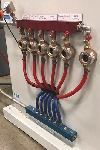

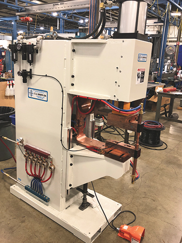

Therefore, with an RW machine running at high speed, an adequate flow of cooling water is one of the most important variables of the resistance-welding process. The typical machine requires 1 to 3 gal./min. per cooling circuit, and sometimes more.
The standard AC resistance welders used for decades by metalformers can tolerate some overheating, but the newer medium-frequency direct-current (MFDC) inverter-power supplies, more commonly used today, are prone to failure due to inadequate water flow.
Often, the required total water flow required is substantial due to several parallel water circuits per machine. For example, the water-cooling needs of specially designed automated multi-gun resistance welders with multiple transformers and tips easily can total water flows of 10 to 20 gal./min.

Starting with the large welding transformer typically located inside the machine frame, the RW process employs numerous heat generators. As the transformer converts incoming line voltage and current into the high secondary amperage necessary for resistance welding, heat generates internally.
When projection welding large fasteners or spot welding aluminum, some RW applications require 50,000 to 100,000 secondary A to generate enough localized heat.

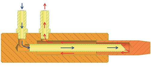

Additional heat, produced in the large copper conductors, comprises the machine’s external secondary loop and final heat source in the RW process. This can be the hardest to cool with heat coming from the electrodes, which make contact and conduct the welding current.
Small, easily clogged water-cooling copper tubes built into the welder’s internal secondary circuit cool most resistance-welding transformers. Other water circuits cool the high-voltage contactor section of the control.
