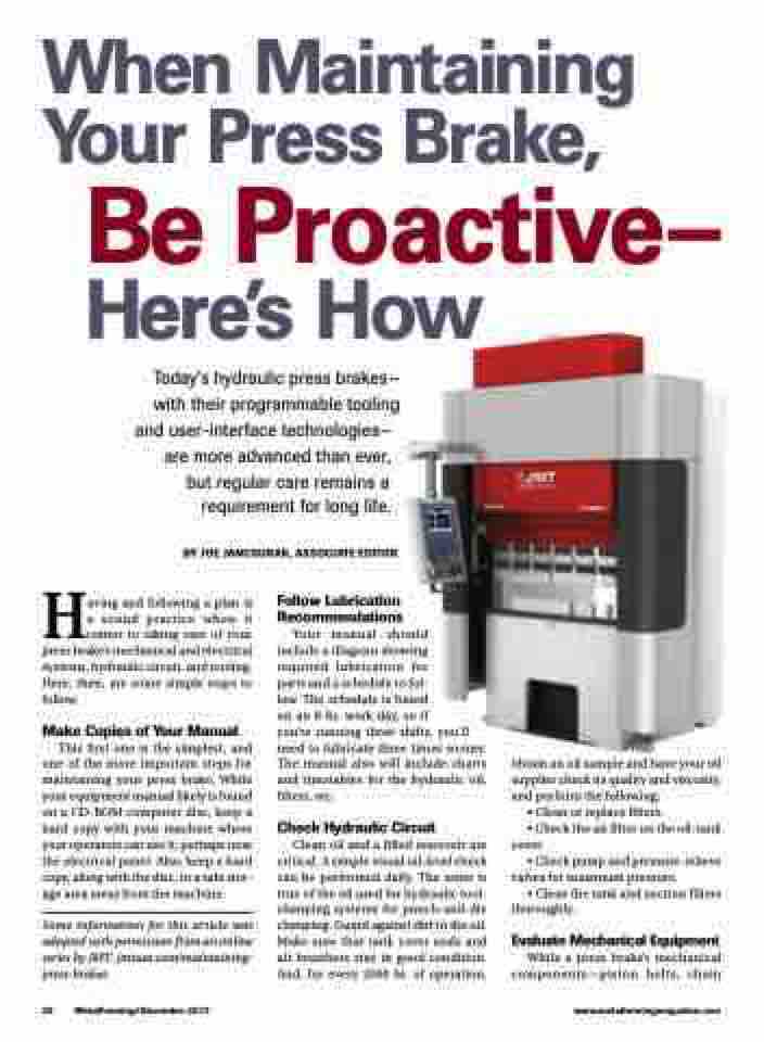

When Maintaining Your Press Brake,
Be Proactive–
Here’s How
Today’s hydraulic press brakes—
with their programmable tooling and user-interface technologies— are more advanced than ever,
but regular care remains a requirement for long life.
 Having and following a plan is a sound practice when it comes to taking care of your press brake’s mechanical and electrical systems, hydraulic circuit, and tooling. Here, then, are some simple steps to follow.
