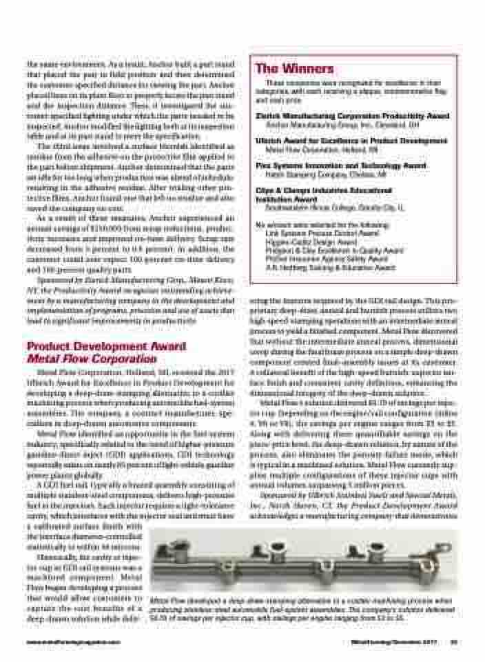

Metal Flow Corporation, Holland, MI, received the 2017 Ulbrich Award for Excellence in Product Development for developing a deep-draw-stamping alternative to a costlier machining process when producing automobile fuel-system assemblies. The company, a contract manufacturer, spe- cializes in deep-drawn automotive components.
Metal Flow identified an opportunity in the fuel-system industry, specifically related to the trend of higher-pressure gasoline-direct-inject (GDI) applications. GDI technology reportedly exists on nearly 85 percent of light-vehicle gasoline power plants globally.
A GDI fuel rail, typically a brazed assembly consisting of multiple stainless-steel components, delivers high-pressure fuel to the injectors. Each injector requires a tight-tolerance cavity, which interfaces with the injector seal and must have a calibrated surface finish with
ering the features required by the GDI rail design. This pro- prietary deep-draw, anneal and burnish process utilizes two high-speed-stamping operations with an intermediate anneal process to yield a finished component. Metal Flow discovered that without the intermediate anneal process, dimensional creep during the final braze process on a simple deep-drawn component created final-assembly issues at its customer. A collateral benefit of the high-speed burnish: superior sur- face finish and consistent cavity definition, enhancing the dimensional integrity of the deep-drawn solution.
Metal Flow’s solution delivered $0.70 of savings per injec- tor cup. Depending on the engine/rail configuration (inline 4, V6 or V8), the savings per engine ranges from $3 to $5. Along with delivering these quantifiable savings on the piece-price level, the deep-drawn solution, by nature of the process, also eliminates the porosity-failure mode, which is typical in a machined solution. Metal Flow currently sup- plies multiple configurations of these injector cups with annual volumes surpassing 5 million pieces.
Sponsored by Ulbrich Stainless Steels and Special Metals, Inc., North Haven, CT, the Product Development Award acknowledges a manufacturing company that demonstrates
 the interface diameter-controlled statistically to within 50 microns. Historically, the cavity or injec- tor cup in GDI rail systems was a machined component. Metal Flow began developing a process that would allow customers to capture the cost benefits of a deep-drawn solution while deliv-
Metal Flow developed a deep-draw-stamping alternative to a costlier machining process when producing stainless-steel automobile fuel-system assemblies. The company’s solution delivered $0.70 of savings per injector cup, with savings per engine ranging from $3 to $5.
