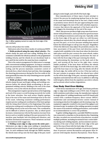

 Wheel starts rolling up onto part
Current starting before wheel comes in contact with part, which overheats front edge of part
Displacement data (top) and current data (bottom) collected with WeldView monitor
  Fig. 2—When applying current too early, the front edge of the part overheats.
velocity will produce hot welds.

3. Welding occurs edge-to-edge across the entire part—
Fabricators use edge-to-edge seam welding to manufacture products such as water heaters, 55-gal. drums, pails and aerosol cans. As each weldment feeds through the RSEW machine, the wheels must roll up onto the front edge of the part, travel
along its entire length, and roll off of the back edge.
Most manufacturers of these types of parts attempt to control the process by employing upslope heat at the start of the seam and downslope heat at the end. A limit switch or proximity sensor detects the part approaching the seam wheels and triggers the start of the weld-schedule sequence. A sensor that detects the approach of the back end of the
part triggers the downslope at the end of the seam.
Often, this process produces high scrap rates from incon- sistent weld performance, and as production speed increases so do welding inconsistency and scrap rate. Typically, welds on the front edge of the part are either too cold (because welding heat started after the wheels already started to roll up onto the part), or too hot (because welding heat started before the wheels began to roll up onto the part). Regardless of how the fabricator may adjust the proximity sensors, the time uncertainty of the part front-end detection system, coupled with variability in the time from when the detection takes place until the part contacts the seam wheels, makes it nearly impossible to accurately synchronize the start of
heat with the front edge of the part entering the wheels. Synchronizing the downslope on the back end of the part, and turning off the heat at the right time, creates similar problems. If the heat shuts off before the wheels begin to roll off of the back edge, the welds will be too cold, and if the heat stays on too long, after the wheels roll off of the back edge, the welds will be too hot. If the last weld on the part remains in progress when the wheels have rolled too far off the back edge of the part, excessive sparking from expulsion and material loss will occur. In addition to affecting weld integrity, debris from the expulsion can stick to wheels
