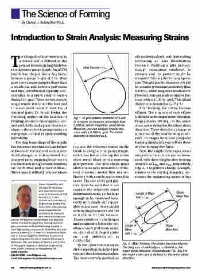

Fig. 1—A grid pattern diameter of 0.200 in. is easier to measure accurately than 0.100 in., which magnifies small errors. However, you can analyze smaller fea- tures with a 0.100-in. grid. This initial diameter is denoted as Li.

electrochemical etch, with laser etching increasing as laser installations increase. Painting a grid pattern, though sometimes employed, is messier and the pattern might be scraped off during the forming opera- tion. The grid pattern diameter of 0.200 in. is easier to measure accurately than 0.100 in., which magnifies small errors. However, you can analyze smaller fea- tures with a 0.100-in. grid. This initial diameter is denoted as Li (Fig. 1).
After forming, the circles become ellipses. The long axis of each ellipse is defined as the major strain direction. Perpendicular (90 deg.) to the major strain axis is defined as the minor strain direction. These directions change as a function of the local forming condi- tions. In images from your computer forming simulation, you will see these as your forming flow lines.
Next, the length of the major strain axis and the minor strain axis are meas- ured, with these lengths after forming denoted as LMa and Lmi, respectively (Fig. 2). The percent change in length, relative to the starting diameter, rep- resents the engineering strain in that

Fig. 2—After forming, the circles become ellipses. The long axis of each ellipse is defined as the major strain direction. Perpendicular (90 deg.) to the major strain axis is defined as the minor strain direction.
