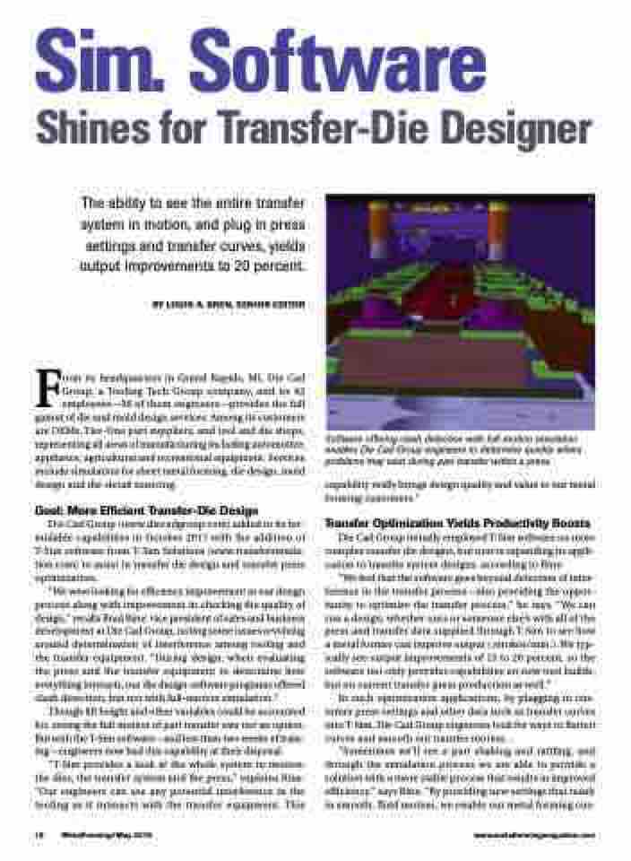

“T-Sim provides a look at the whole system in motion: the dies, the transfer system and the press,” explains Rine. “Our engineers can see any potential interference in the tooling as it interacts with the transfer equipment. This
Software offering clash detection with full-motion simulation enables Die Cad Group engineers to determine quickly where problems may exist during part transfer within a press.
