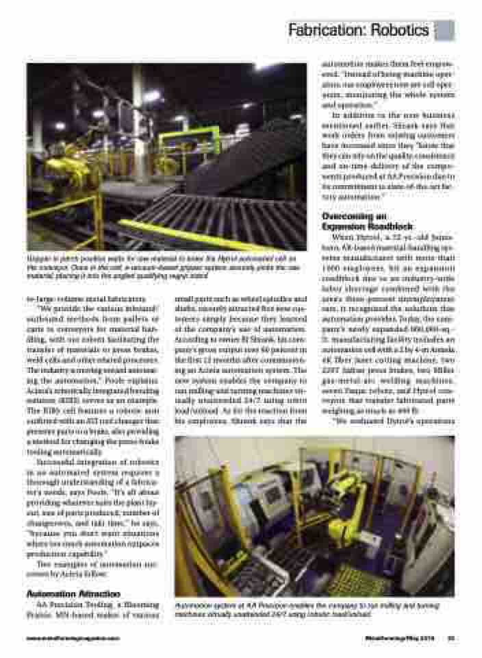

   Gripper in perch position waits for raw material to enter the Hytrol automated cell on the conveyor. Once in the cell, a vacuum-based gripper system securely picks the raw material, placing it into the angled qualifying regrip stand.

Automation system at AA Precision enables the company to run milling and turning machines virtually unattended 24/7 using robotic load/unload.
