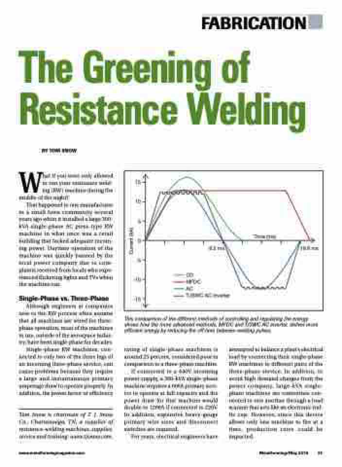

This comparison of the different methods of controlling and regulating the energy shows how the more advanced methods, MFDC and TJSWC AC inverter, deliver more efficient energy by reducing the off time between welding pulses.
FABRICATION
    15
10
5
-5
-10
-15
Time (ms)
                 8.3 ms
CD
MFDC
AC
TJSWC AC Inverter
16.6 ms
