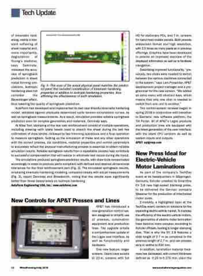

ulations. Isotropic
hardening does not
consider the
Bauschinger effect,
thus lowering the quality of springback prediction.
AutoForm has developed and implemented its own user-friendly kinematic hardening model, validated against physically determined cyclic tension-compression curves, as well as springback measurements. As a result, simulation provides reliable springback prediction even for complex geometries and materials, Demiralp says.
At Atlas Tool, stamping of the rear cab reinforcement consist of multiple operations, including drawing—with stake beads used to stretch the sheet during the last few millimeters of draw stroke—followed by two trimming operations and a final operation to measure springback. Setting up the simulation of these and any other operations with the correct process, die conditions, material properties and control parameters to accurately reflect the physical manufacturing process is essential to obtain reliable simulation results. Reliable springback results from a repeatable process help contribute to successful compensation that will reduce or eliminate tool recuts during die tryout.
The simulations produced springback-prediction results, with draw tools compensated accordingly in order to produce parts compliant with defined and desired dimensional tolerances for the final reinforcement part (Fig. 2). The simulated springback results, employing kinematic hardening modeling, compared closely with actual measurements (Fig. 3), report Demiralp and Broadworth, noting that the results were significantly better than those based solely on isotropic hardening.

Fig. 3—This scan of the actual physical panel matches the predict- ed panel that included consideration of kinematic hardening properties in addition to isotropic hardening properties, thus affirming the effectiveness of such simulation.
