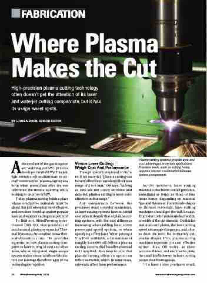

Plasma cutting systems provide time and cost advantages in certain applications. Precision work, such as cutting holes, requires precise coordination between system components.
