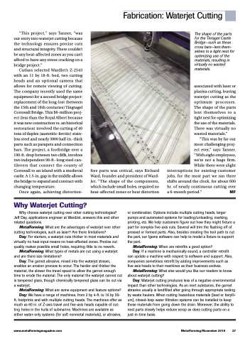

The shape of the parts for the Tintagel Castle Bridge—such as these cross bars—lent them- selves to a tight nest for optimizing use of the materials, resulting in virtually no wasted materials.
associated with laser or plasma cutting, leaving waterjet cutting as the optimum processes. The shape of the parts lent themselves to a tight nest for optimizing the use of the materials. There was virtually no wasted materials.”
