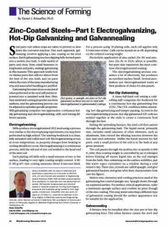

 Zinc grains, or spangle, are seen on hot-dip galvanized surfaces but not on steel with electrogalvanized or galvannealed coatings.
mon electrogalvanized coating.

The coil passes through the molten zinc at speeds to 600 ft./min. Zinc coating weight is controlled by air or nitrogen knives blowing off excess liquid zinc as the coil emerges from the bath. Zinc remaining on the surface solidifies, just like water vapor crystalizes on a window during a cold winter’s day. These zinc crystals are called spangle, and give galvanized buckets and grain silos their characteristic look (see the figure).
Molten zinc chemistry and cooling practices used at the galvanizing line control spangle size. Spangle shows through on a painted surface. For surface-critical applications, order a minimum-spangle surface and confirm no print-though of the zinc coating. This may mean selecting a different type of galvanized coating should the surface appearance not be suitable for the application.
