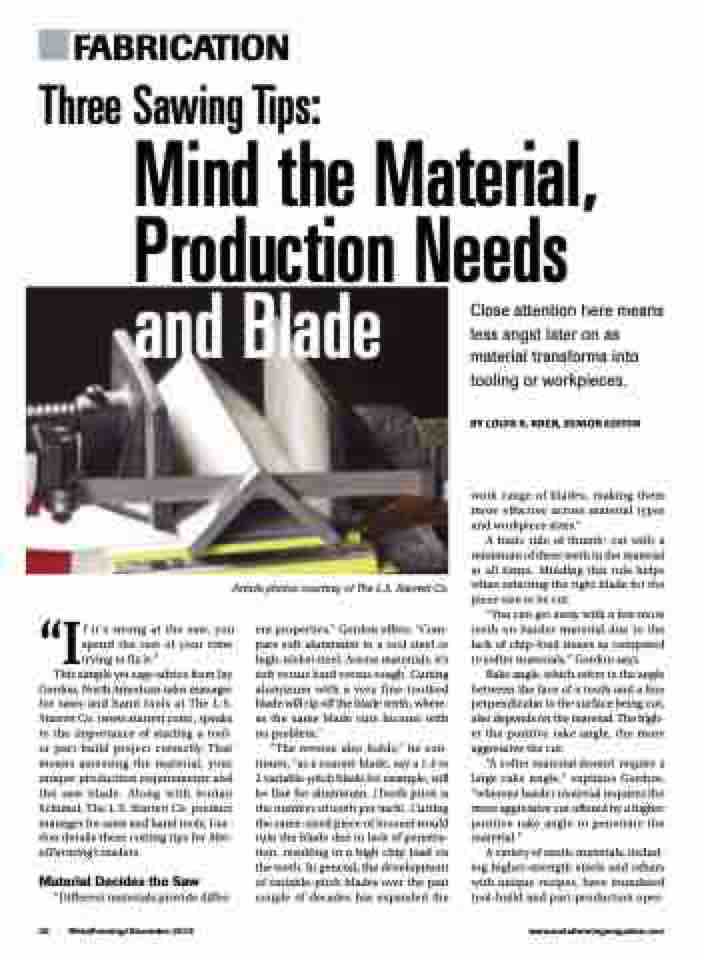

Article photos courtesy of The L.S. Starrett Co.
Close attention here means less angst later on as material transforms into tooling or workpieces.
