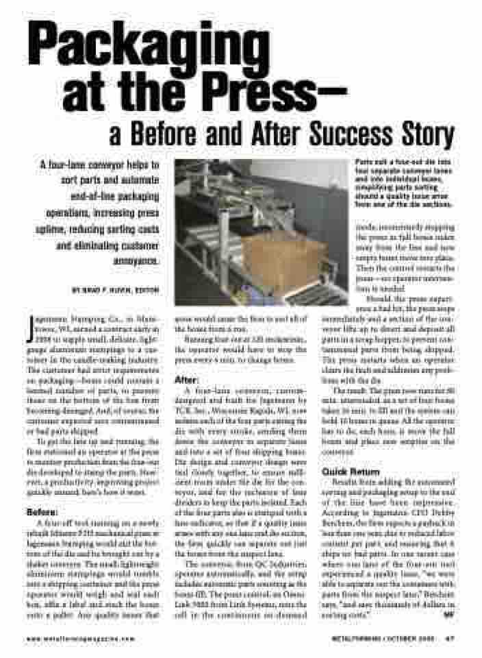

A four-lane conveyor, custom- designed and built for Jagemann by TCR, Inc., Wisconsin Rapids, WI, now isolates each of the four parts exiting the die with every stroke, sending them down the conveyor in separate lanes and into a set of four shipping boxes. Die design and conveyor design were tied closely together, to ensure suffi- cient room under the die for the con- veyor, and for the inclusion of lane dividers to keep the parts isolated. Each of the four parts also is stamped with a lane indicator, so that if a quality issue arises with any one lane and die section, the firm quickly can separate out just the boxes from the suspect lane.
The conveyor, from QC Industries, operates automatically, and the setup includes automatic parts counting as the boxes fill. The press control, an Omni- Link 5000 from Link Systems, runs the cell in the continuous on-demand
Parts exit a four-out die into four separate conveyor lanes and into individual boxes, simplifying parts sorting should a quality issue arise from one of the die sections.
mode, momentarily stopping the press as full boxes index away from the line and new empty boxes move into place. Then the control restarts the press—no operator interven- tion is needed.
Should the press experi- ence a bad hit, the press stops immediately and a section of the con- veyor lifts up to divert and deposit all parts in a scrap hopper, to prevent con- taminated parts from being shipped. The press restarts when an operator clears the fault and addresses any prob-
lems with the die.
The result: The press now runs for 60
min. unattended, as a set of four boxes takes 26 min. to fill and the system can hold 16 boxes in queue. All the operator has to do, each hour, is move the full boxes and place new empties on the conveyor.
