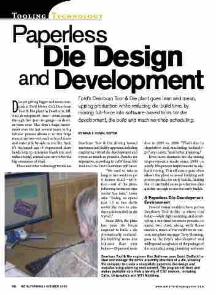

Dearborn Tool & Die engineer Ken Rothman uses Smirt DieBuild to view and manage the entire assembly structure of a die, allowing the company to create a completely paperless die-design and manufacturing-planning environment. The program retrieves and makes available data from a variety of CAD sources, including Catia, Unigraphics and VISI Modeling.
