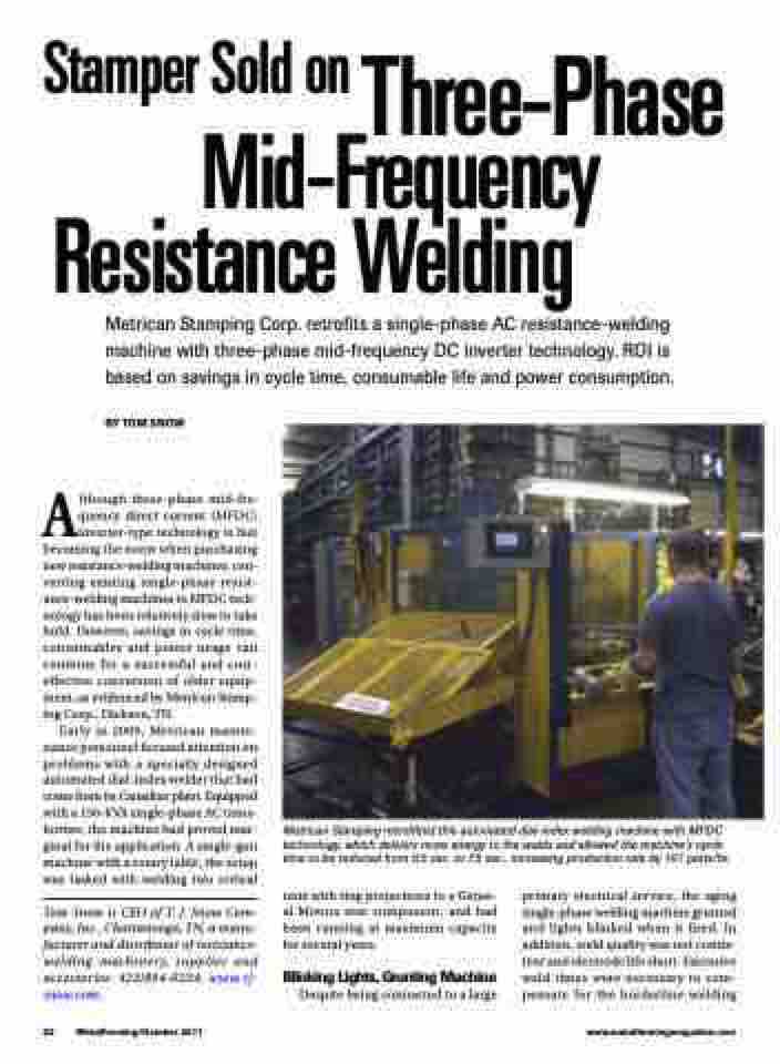

Early in 2009, Metrican mainte- nance personnel focused attention on problems with a specially designed automated dial-index welder that had come from its Canadian plant. Equipped with a 150-KVA single-phase AC trans- former, the machine had proved mar- ginal for the application. A single-gun machine with a rotary table, the setup was tasked with welding two critical
Tom Snow is CEO of T. J. Snow Com- pany, Inc., Chattanooga, TN, a manu- facturer and distributor of resistance- welding machinery, supplies and accessories: 423/894-6234; www.tj- snow.com.
Metrican Stamping retrofitted this automated dial-index welding machine with MFDC technology, which delivers more energy to the welds and allowed the machine’s cycle time to be reduced from 9.5 sec. to 7.5 sec., increasing production rate by 101 parts/hr.
 nuts with ring projections to a Gener- al Motors seat component, and had been running at maximum capacity for several years.
Blinking Lights, Grunting Machine
Despite being connected to a large
primary electrical service, the aging single-phase welding machine grunted and lights blinked when it fired. In addition, weld quality was not consis- tent and electrode life short. Excessive weld times were necessary to com- pensate for the borderline welding
