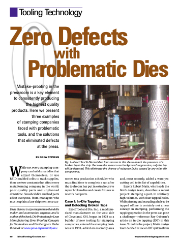

Fig. 1—Exact Tool & Die installed four sensors in this die to detect the presence of a broken tap in the strip. Because the sensors use background suppression, only the tap will be detected. This eliminates the chance of nuisance faults caused by any other die components.

Exact’s Robert Matis, who heads the firm’s design team, describes a recent project: stamping a part, to relatively high volumes, with four tapped holes. While piercing and extruding a hole to be tapped offline is certainly not a new concept in stamping, performing the tapping operation in the press can pose a challenge—reference Ray Osborne’s article on in-die tapping (IDT) in this issue. To tackle the project, Matis’ design team decided to use an IDT system (from
