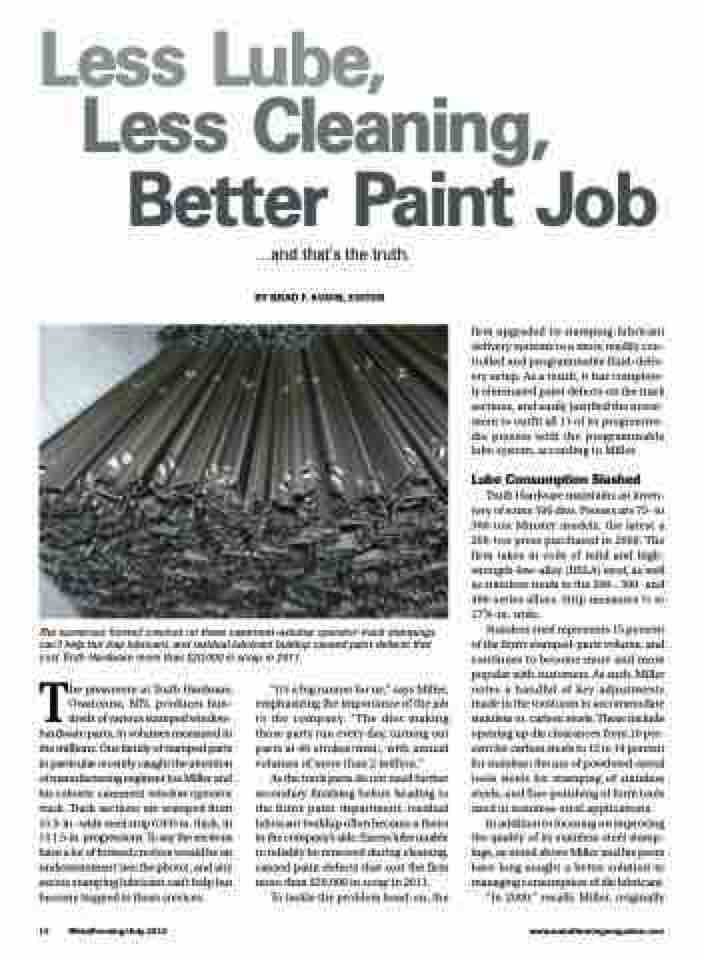

 The numerous formed crevices on these casement-window operator-track stampings can’t help but trap lubricant, and residual lubricant buildup caused paint defects that cost Truth Hardware more than $20,000 in scrap in 2011.

The pressroom at Truth Hardware, Owatonna, MN, produces hun- dreds of various stamped window- hardware parts, in volumes measured in the millions. One family of stamped parts in particular recently caught the attention of manufacturing engineer Joe Miller and his cohorts: casement-window operator track. Track sections are stamped from 15.5-in.-wide steel strip 0.035 in. thick, in 13 1.5-in. progressions. To say the sections have a lot of formed crevices would be an understatement (see the photo), and any excess stamping lubricant can’t help but become trapped in those crevices.
“It’s a big runner for us,” says Miller, emphasizing the importance of the job to the company. “The dies making those parts run every day, turning out parts at 40 strokes/min., with annual volumes of more than 2 million.”
As the track parts do not need further secondary finishing before heading to the firm’s paint department, residual lubricant buildup often became a thorn in the company’s side. Excess lube unable to reliably be removed during cleaning, caused paint defects that cost the firm more than $20,000 in scrap in 2011.
