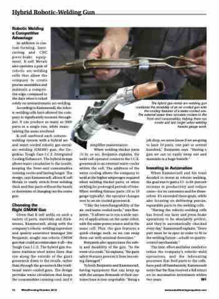

K-zell outfitted each robotic- welding system with a hybrid air- and water-cooled robotic gas-metal- arc-welding (GMAW ) gun, the Tre- gaskiss Tough Gun I.C.E (Integrated Cooling Enhancer). The hybrid design allows water circulation to the nozzle, keeping the front-end consumables running cooler and lasting longer. The design, says Kammerzell, allows K-zell Metals to easily switch from welding thick and thin parts without the hassle or downtime of changing out the entire gun.
Choosing the Right GMAW Gun
Given that K-zell welds on such a variety of parts, materials and thick- nesses, Kammerzell, along with the company’s robotic-welding supervisor and quality-assurance manager Jim Benjamin, sought one robotic GMAW gun that could accommodate it all—the Tough Gun I.C.E. The hybrid gun fea- tures stainless-steel water lines that run along the outside of the gun’s gooseneck down to the nozzle, rather than through the gooseneck like tradi- tional water-cooled guns. The design provides water circulation that keeps the consumables running cool, and it
The hybrid gas-metal-arc-welding gun combines the durability of an air-cooled gun with the cooling features of a water-cooled one. The external water lines circulate coolant to the front-end consumables, helping them run cooler and last longer when welding heavier gauge work.

When welding thicker parts (1⁄4 in. or so), Benjamin explains, the weld-cell operator connects the I.C.E. gooseneck to an external water cooler within the cell. The addition of the water cooling allows the company to weld at the higher amperages required when welding thicker parts, or when welding for prolonged periods of time. When welding thinner parts (16 to 10 gauge typically), the operator changes
over to an air-cooled gooseneck.
“I like the interchangeability of the air- and water-cooled necks,” says Ben- jamin. “It allows us to run a wide vari- ety of applications on the same robot, with the same power source and in the same cell. Plus, the gun features a quick-change neck, so we can swap
them out with minimal downtime.” Benjamin also appreciates the safe- ty and durability of the gun. “In the event of a crash,” he explains, “the gun’s safety features prevent it from becom-
