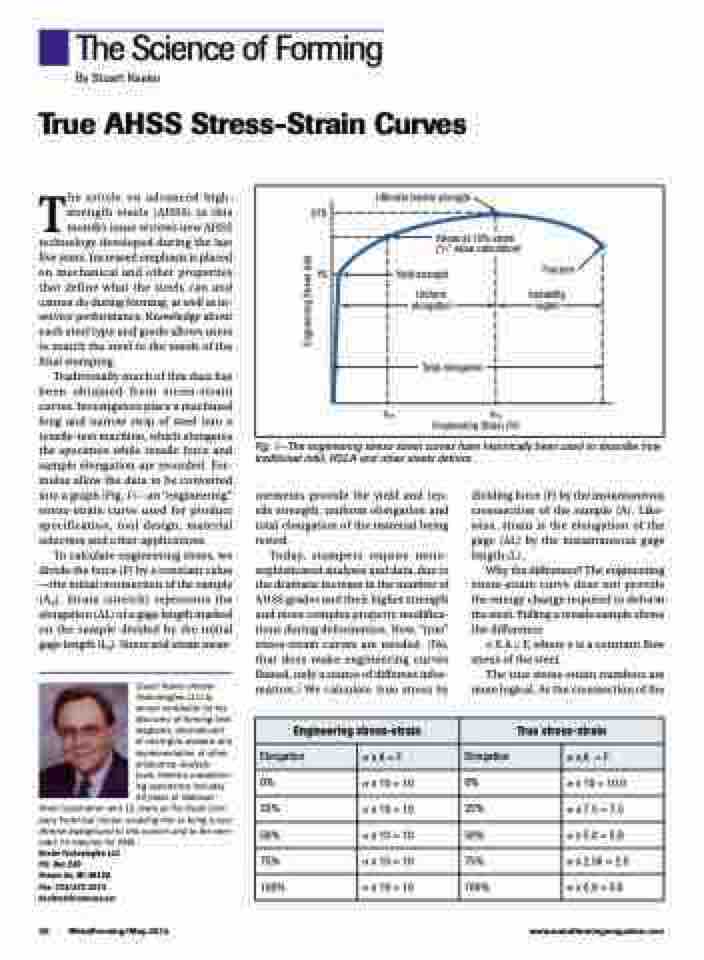

The article on advanced high- strength steels (AHSS) in this month’s issue reviews new AHSS technology developed during the last five years. Increased emphasis is placed on mechanical and other properties that define what the steels can and cannot do during forming, as well as in- service performance. Knowledge about each steel type and grade allows users to match the steel to the needs of the final stamping.
Traditionally much of this data has been obtained from stress-strain curves. Investigators place a machined long and narrow strip of steel into a tensile-test machine, which elongates the specimen while tensile force and sample elongation are recorded. For- mulas allow the data to be converted into a graph (Fig. 1)—an “engineering” stress-strain curve used for product specification, tool design, material selection and other applications.
To calculate engineering stress, we
divide the force (F) by a constant value
—the initial crosssection of the sample

Fig. 1—The engineering stress-strain curves have historically been used to describe how traditional mild, HSLA and other steels deform.
(A ). Strain (stretch) represents the 0
Why the difference? The engineering stress-strain curve does not provide the energy change required to deform the steel. Pulling a tensile sample shows the difference:
elongation (∆L) of a gage length marked on the sample divided by the initial gage length (L0). Stress and strain meas-
σ X A = F, where σ is a constant flow stress of the steel.
urements provide the yield and ten- sile strength, uniform elongation and total elongation of the material being tested.
Today, stampers require more- sophisticated analyses and data, due to the dramatic increase in the number of AHSS grades and their higher strength and more complex property modifica- tions during deformation. Now, “true” stress-strain curves are needed. (No, that does make engineering curves flawed, only a source of different infor- mation.) We calculate true stress by
dividing force (F) by the instantaneous crosssection of the sample (A). Like- wise, strain is the elongation of the gage (∆L) by the instantaneous gage length (L).
The true stress-strain numbers are more logical. As the crosssection of the
       Engineering stress-strain
 True stress-strain
 Elongation
 􏰀xA=F
 Elongation
 􏰀xA =F
0%
􏰀 x 10 = 10
0%
􏰀 x 10 = 10.0
25%
􏰀 x 10 = 10
25%
􏰀 x 7.5 = 7.5
50%
􏰀 x 10 = 10
50%
􏰀 x 5.0 = 5.0
75%
􏰀 x 10 = 10
75%
􏰀 x 2.50 = 2.5
100%
􏰀 x 10 = 10
100%
􏰀 x 0.0 = 0.0
