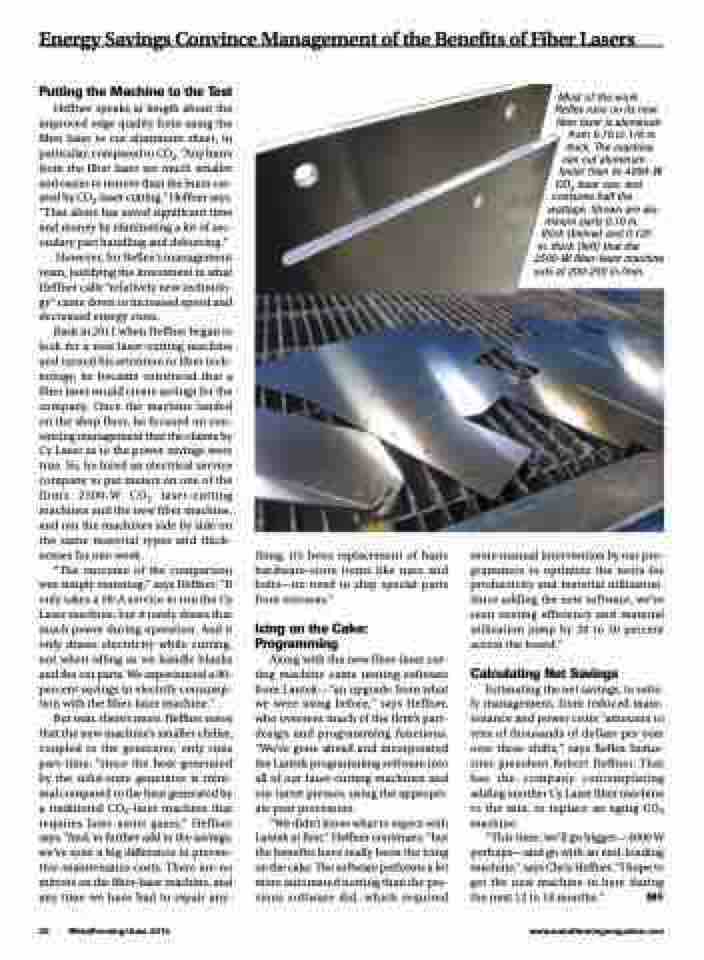

Most of the work Reflex runs on its new fiber laser is aluminum
from 0.10 to 1/8 in. thick. The machine
can cut aluminum faster than its 4000-W
CO2 laser can, and consume half the
wattage. Shown are alu- minum parts 0.10 in.
thick (below) and 0.125 in. thick (left) that the
2500-W fiber-laser machine cuts at 200-250 in./min.
