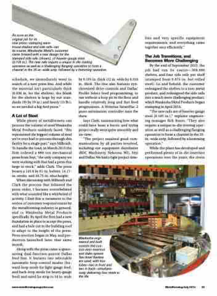

 As soon as the
original job for its
new press—stamping ware-
house shelves and side rails—ran
its course, Waukesha Metal’s customer
came forward with a new design for the
stamped side rails (shown), of heavier-gauge steel
(0.105 in.). The new rails require a unique in-die riveting
operation as well as a challenging flanging operation to form a channel in the 35-in.-wide strip, followed by a hemming operation.
line and very specific equipment requirements, and everything came together very efficiently.”
The Job Transitions, and Becomes More Challenging
By the end of September 2013, the job had run its course—300,000 shelves, and four side rails per shelf (stamped from 0.075-in. hot-rolled steel). Lo and behold, the customer redesigned the shelves to a non-metal product, and redesigned the side rails into a much more challenging product, which Waukesha Metal Products began stamping in April 2014.
“The new rails are of heavier-gauge steel (0.105 in.),” explains engineer- ing manager Rob Bauer. “They also require a unique in-die riveting oper- ation as well as a challenging flanging operation to form a channel in the 35- in.-wide strip, followed by a hemming operation.”
While the plant has developed and performed plenty of in-die insertion operations over the years, the rivets

Waukesha engi-
neered and built
custom this cus-
tom rivet-insertion
and stake system.
Two bowl feeders
are used, with four tubes—two in front and
two in back—simultane- ously delivering four rivets to the die.
