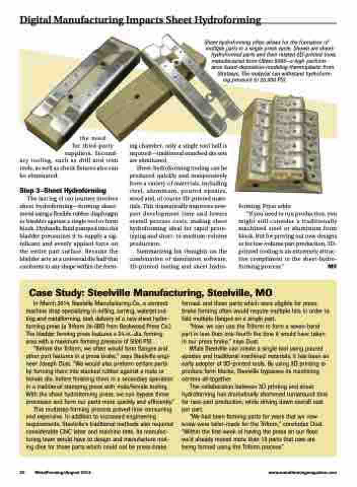

Sheet hydroforming often allows for the formation of multiple parts in a single press cycle. Shown are sheet-
hydroformed parts and their related 3D-printed tools, manufactured from Ultem 9085—a high-perform- ance fused-deposition-modeling thermoplastic from
Stratasys. The material can withstand hydroform- ing pressure to 20,000 PSI.
