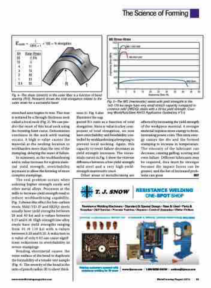

Fig. 4—The strain (stretch) in the outer fiber is a function of bend severity (R/t). Research shows the total elongation relates to the outer strain for a successful bend.
stretched area begins to tear. This tear is initiated by a through-thickness neck called a local neck (Fig. 2). We can pre- dict the onset of this local neck using the forming limit curve. Deformation continues in the neck until tearing occurs. A high n-value causes the material at the necking location to workharden more than the rest of the stamping, delaying the onset of failure.
In summary, as the workhardening and n-value increase for a given mate- rial yield strength, stretchability increases to allow the forming of more complex stampings.
The real problem occurs when ordering higher strength steels and other metal alloys. Processes at the mills to increase yield strength tend to reduce workhardening capability. Fig. 3 shows this effect for low-carbon steels. Mild (VD-IF and AKDQ) steels usually have yield strengths between 20 and 40 ksi and n-values between 0.27 and 0.18. High-strength low-alloy steels have yield strengths ranging from 35 t0 110 ksi with n-values between 0.20 and 0.10. A reduction in n-value of only 0.02 can cause signif- icant reductions in stretchability in severe stampings.
Bending sheetmetal causes the outer surface of the bend to duplicate the formability of a tensile-test sample (Fig. 4). The severity of the bend is the ratio of punch radius (R) to sheet thick-
Fig. 5—The MS (martensitic) steels with yield strengths in the 140-170 ksi range have very small stretch capacity compared to common mild (AKDQ) steels with a 30 ksi yield strength. Cour- tesy WorldAutoSteel AHSS Application Guidelines V 5.0.

outer = 1 × 100 = % elongation 2(R/t) + 1
R/t Outer Strain 20 2.5% 10 5
4 11 3 15 2 20 1 33 0.5 50

MS Stress-Strain
1600 1400 1200 1000
800 600 400 200
0 5 10 15 20 25 30 35 40 45 50
Engineering Strain (%)
MS 1150/1400
MS 950/1200
Mild Steel
ness (t). Fig. 4 also
illustrates the sug-
gested R/t ratio as a function of total elongation. Since n-value is a key com- ponent of total elongation, we now have stretchability and bendability con- trolled by workhardening attempting to prevent local necking. Again, this capacity to resist failure decreases as yield strength increases. The stress- strain curves in Fig. 5 show the extreme difference between a low-yield-strength mild steel and a very high-yield- strength martensitic steel.
