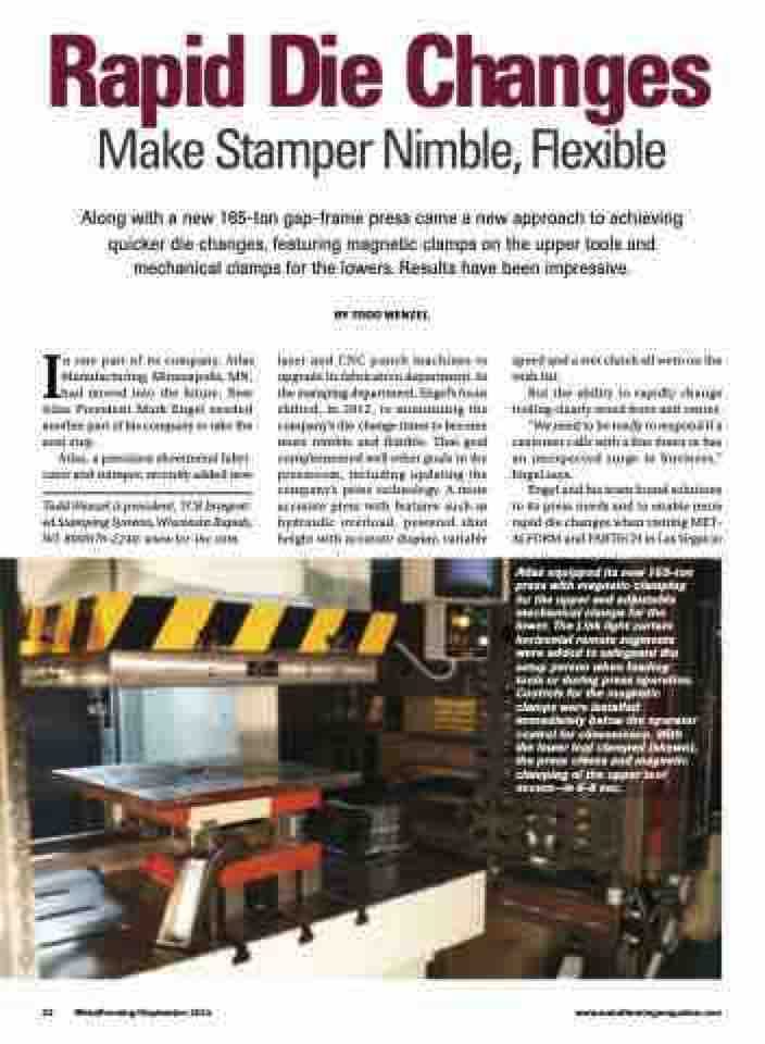

   Atlas equipped its new 165-ton press with magnetic clamping for the upper and adjustable mechanical clamps for the lower. The Link light curtain horizontal remote segments were added to safeguard the setup person when loading tools or during press operation. Controls for the magnetic clamps were installed immediately below the operator control for convenience. With the lower tool clamped (shown), the press closes and magnetic clamping of the upper tool occurs—in 6-8 sec.

Along with a new 165-ton gap-frame press came a new approach to achieving quicker die changes, featuring magnetic clamps on the upper tools and mechanical clamps for the lowers. Results have been impressive.
