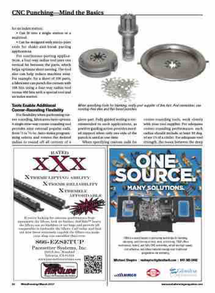

For continuous-parting applica- tions, a four-way radius tool uses one vertical hit between the parts, which helps optimize sheet nesting. The tool also can help reduce machine wear. For example, for a sheet of 100 parts, a fabricator can punch the corners with 108 hits using a four-way radius tool versus 400 hits with a special tool and an index station.
Tools Enable Additional Corner-Rounding Flexibility
For flexibility when performing cor- ner-rounding, fabricators have options. A single nine-way corner-rounding tool provides nine external popular radii, from 1⁄2 to 1⁄16 in. Auto-index program- ming selects and rotates the desired radius to round off all corners of a
When specifying tools for blanking, notify your supplier of this fact. And remember, use nonslug-free dies and flat-faced punches.
