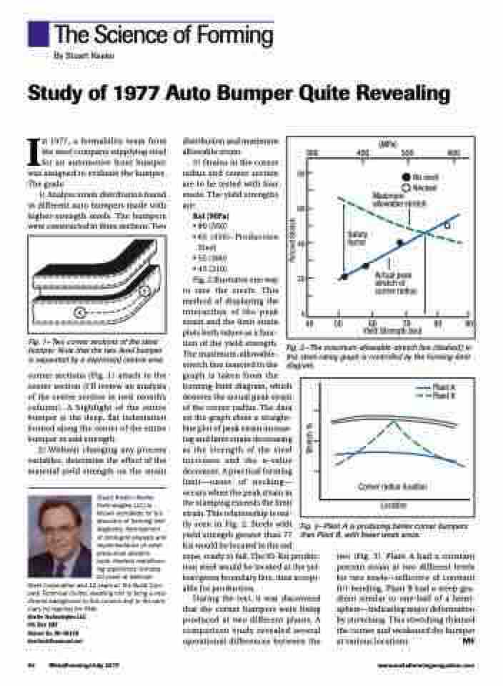

In 1977, a formability team from the steel company supplying steel for an automotive front bumper
was assigned to evaluate the bumper. The goals:

Fig. 2 illustrates one way
  80
60
40
20
No neck
Necked Maximum
allowable stretch
Safety factor
300
(MPa)
400 500 600
              Actual peak stretch of corner radius
       40 50 60 70 80 90 Yield Strength (ksi)
 X

to rate the steels. This
method of displaying the interaction of the peak
strain and the limit strain
plots both values as a func-
tion of the yield strength.
The maximum-allowable-
stretch line inserted in the
graph is taken from the forming-limit diagram, which denotes the actual peak strain
of the corner radius. The data
on the graph show a straight-
line plot of peak strain increas-
ing and limit strain decreasing
as the strength of the steel increases and the n-value decreases. A practical forming limit—onset of necking—
occurs when the peak strain in
the stamping exceeds the limit
strain. This relationship is eas-
ily seen in Fig. 2. Steels with
yield strength greater than 77
Ksi would be located in the red
zone, ready to fail. The 65-Ksi produc- tion steel would be located at the yel- low/green boundary line, thus accept- able for production.
During the test, it was discovered that the corner bumpers were being produced at two different plants. A comparison study revealed several operational differences between the
Y
Fig. 2—The maximum-allowable-stretch line (dashed) in this steel-rating graph is controlled by the forming-limit diagram.
     Location
 Plant A Plant B
   Corner radius location
  84 MetalForming/July 2017
Fig. 3—Plant A is producing better corner bumpers than Plant B, with fewer weak areas.
two (Fig. 3). Plant A had a constant percent strain at two different levels for two steels—reflective of constant R/t bending. Plant B had a steep gra- dient similar to one-half of a hemi- sphere—indicating major deformation by stretching. This stretching thinned the corner and weakened the bumper at various locations. MF
Stretch %
Percent Stretch
