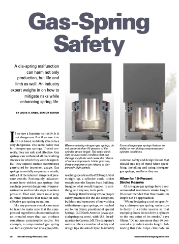

When employing nitrogen-gas springs, do not use more than 90 percent of the cylinder stroke length. This helps elimi- nate an overstroke condition that can damage a cylinder and cause the release of some components. Under pressure, these components can release at dan- gerously high speeds.

Some nitrogen-gas springs feature the ability to vent during overpressurized- cylinder conditions.

Allow for 10-Percent Stroke Reserve
All nitrogen-gas springs have a rec- ommended maximum stroke length. It’s recommended that this maximum length not be approached.
“When designing a tool or specify- ing a nitrogen-gas spring, make sure to factor in a stroke reserve so that stamping forces do not drive a cylinder to the endpoint of its stroke,” says Glynn. “Do not use more than 90 per- cent of a cylinder’s stroke length. Fol- lowing this rule helps eliminate an
