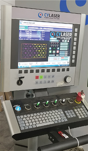

The laser cutter helps the company save on material via optimized-nesting software (see the tight nesting pattern on the control screen), as well as the ability to cut closer to sheet edges and use remnant sheets to cut parts. |

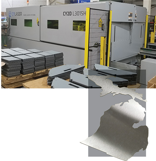

“When we started needing more flat parts we bought our first turret punch press, 13 years ago, and six years ago added another,” says Wortman. “Then we started thinking about programming for laser cutting.”

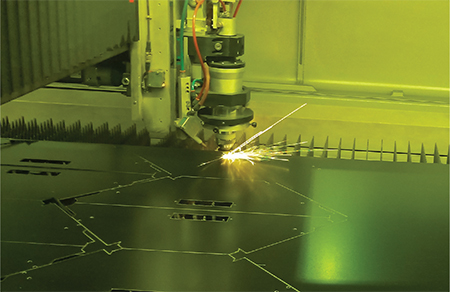

Thinking gave way to doing, as in April 2018 the company installed a 2-kW fiber laser-cutting machine from CYLaser America LLC, Sterling Heights, MI. Ease of install and operation enabled it to contribute to production within a week. The CY2D L3015 2D laser, featuring a 5 by 10-ft. work area, resides in Detroit Radiant Products’ CNC room with the two turret presses and three of the plant’s four press brakes. The fiber laser cutter can process mild steel in thicknesses to 0.6255 in., and stainless steel and aluminum to 0.25 in., with repeatability precision to 0.001 in.
Even with overall high volumes, given so many different specific products the company finds plenty of lower-volume opportunities to bring its new machine into the manufacturing equation, complementing a robust stamping-press lineup. In operation at Detroit Radiant Products, the laser machine primarily cuts mild and stainless steels as well as aluminum (some of that material coated) in thicknesses from 0.024 to 0.125 in.
“We typically use the laser machine on flat-part volumes to 5000/yr.” says Wortman, who, along with Mark Stapleton, the company’s plant manager-maintenance, and Cody Stewart, sales coordinator, provided MetalForming with a plant-floor tour. “We have enough niche business to keep the CNC equipment, including the laser machine, busy. The laser only cuts flat, but the cut is so clean. For an internal part or a part requiring threading, we use the turret presses, but for a clean, fast cut on a visible part, that part is destined for the laser.”

Quicker to program and set up than the company’s turret punch presses, the laser-cutting machine can have a sample part programmed and under the laser within 15 min., where programming and tool setup for a turret unit may take as long as a day. Quicker and neater cuts provide a laser-cutting advantage, especially, as mentioned above, on visible parts.
The new machine also saves on material as compared to the turret punch presses via optimized-nesting software, as well as the ability to cut closer to sheet edges use remnant sheets to cut parts.
