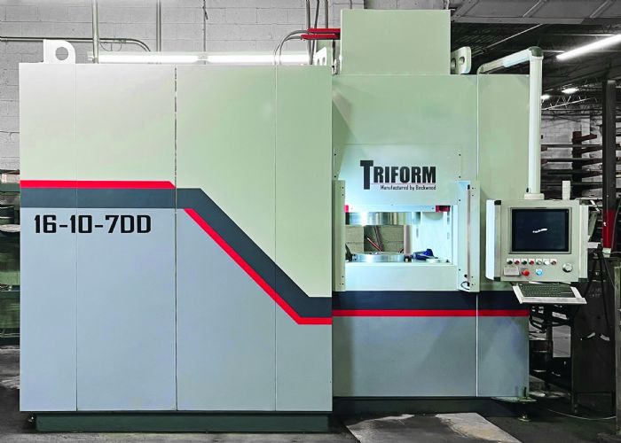

In less than a year’s time, the production team at Philadelphia-area Charles Schillinger Co., Bensalem, PA, has developed and run more than 75 jobs for its new deep-draw sheet-hydroforming machine. A full-service metal former, the firm added the new press to its 40,000-sq.-ft. production floor in late-summer 2023. It’s a 10,000-psi Triform model from Beckwood Press, bought to replace a past-its-prime 1968-vintage hydroformer. Per Beckwood literature, Triform deep-draw presses employ a pressurized rubber diaphragm that serves as a universal female die section. As pressure is applied, a punch extends into the diaphragm, which the firm says can form complex geometries to 12-in. dia. in a single cycle.
triform sheet hydroforming press charles schillingerCharles Schillinger Co., a 95+-yr.-old metal-spinning and deep-draw metal former that also provides metal stamping, CNC machining and welding, hydroforms shapes to 12-in. dia., drawn to a maximum depth of 7 in.

The most notable difference between the old and new sheet-hydroforming machines lies in how the machines generate their pressure. Beckwood sales manager Caleb Dixon explains:
“Most older hydroforming machines for sheet forming have been replaced by modernized machines, which have become the cornerstone technology for progressive deep drawing companies, and at job shops such as Schillinger the advantages are numerous. Those older machines used a concept called displacement pressure to deliver forming pressure to the bladder. That technology made it difficult, if not impossible, to use smaller punches on larger machines, because the small punch could not displace enough hydraulic fluid in the chamber to generate adequate forming pressure. That limitation required metal forming companies to operate two or more machines to cover the range of part sizes.
“Modern sheet-hydroforming machines,” Dixon continues, “do not rely on displacement pressure; they can generate the needed pressure at any given draw height regardless of punch size. One machine, therefore, can cover a broad range of punch and part sizes.”

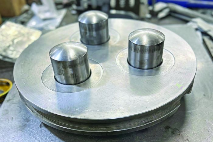

He then offers a tremendous productivity bonus with the new machine: reengineering a one-out draw-forming die to three-out, effectively tripling productivity.
“We’ve been running this part for years,” explains John F. McGeever, describing the part as a 3.5-in.-dia. pressure-vessel head drawn from 18-gauge stainless steel. “With the pressure-generating capability of the new hydroforming machine, we’re able to build enough pressure across the entire bladder to simultaneously drive three punches, drawing three parts per cycle.”

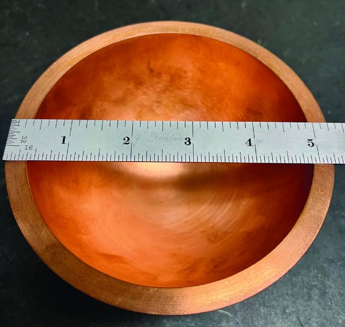

This new-found confidence in the accuracy and repeatability of its sheet-hydroforming capabilities has Charles Schillinger taking on projects it might have no-quoted previously. Example: A customer in California recently approached the McGeevers looking to form 5-in.-dia. hemispherical parts from ⅜-in.-thick copper. “Knowing the capabilities of the Triform, not only did we quote the job, but we landed it,” John Ryan shares.
