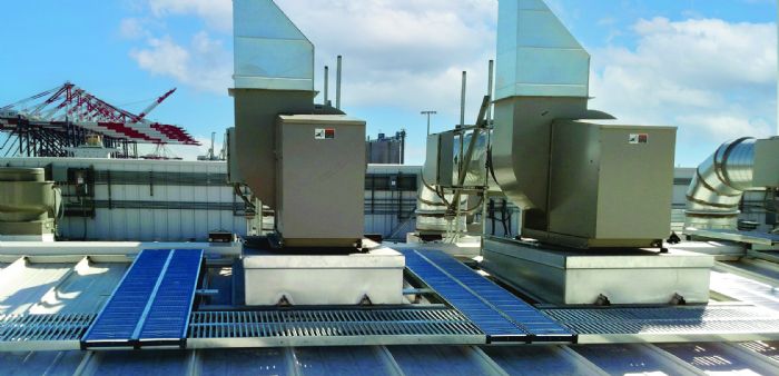

“Because domestic prices were so high from distributors, my father-in-law paid for the tooling and had manufacturing performed overseas, with about 1400 planks per load shipped to us,” McClung explains. “We had to manage the inventory and ensure that we stayed ahead of demand. If we had a large deal beyond what we had in stock, we’d have to order, and that order could take two to three months to arrive. As the roofing systems became more popular, this became a bigger problem.”
2-mechanical-presses-walkway-planks-Amada-Press-R-S-Roof-ProductsAnother problem revolved around material specs for planks, as in the 2020-2021 timeframe, the R&S team found that it could not always confirm that the supplied planks met the G90 (90-weight zinc coating) galvanized steel standard per the product specification. These problems led the team to consider bringing production inhouse to better control supply and material quality, and consultation began with Amada Press System on a stamping solution—a logical choice given McClung’s satisfaction with its growing fleet of Amada fabricating equipment.

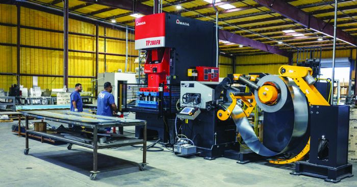

After more than a year of due diligence, R&S Roof Products made the leap to inhouse stamping of the planks, courtesy of Amada Press System. In October of 2023, the firm had its new press and companion feeder/straightener installed and running. The press, a 220-ton model TP 200 FX single-crank mechanical machine, features a standard stroke length of 7.874 in. and can run to 55 strokes/min. Designed to automate single-hit stamping operations and ideal for blanking, bending, drawing and progressive-die operations, the press includes a color touchscreen control. And, to reduce power consumption, TP-FX-series presses offer an Eco-Counter function, allowing them to enter idled states and consume less electricity when reaching preset counts or preset time periods.

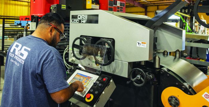

The compact LCC HF feeder/straightener comes standard with two sets of entry-coil vertical guide rollers and provides easily adjustable roll pressure through an air cylinder, offer Amada Press System officials. An energy-saving roll lift mechanism with automatic control of pneumatic cylinder pressure for material straightening enables optimization according to stock thickness, and reportedly achieves energy savings of 30 to 50%. Other reported features include large straightening-roll-adjustment handwheels with easy-to-read indicators for improved repeatability, and a control system designed to optimize production efficiency, planning and maintenance. LCC HF series straightener/feeders handle stock widths to 39 in., stock thicknesses to 0.177 in. and coils weighing to 15,435 lb. Feed lengths range from 1 to 19 in., with maximum line speed of 78 ft./min.
“We knew absolutely nothing about metal stamping and leaned on the Amada Press System team to get us up and running,” McClung says. “We were provided with excellent documentation, and our electrician wired and prepped everything. Installation and ramp-up occurred very quickly.”

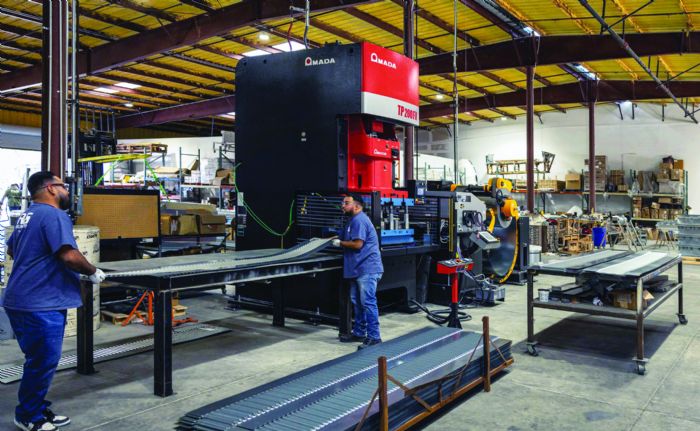

4-Mechanical-presses-plank-unloading-Amada-Press-R-S-Roof-ProductsA team from a Michigan tool & die shop—chosen by R&S Roof Products as its press-tooling supplier—spent 3 days installing tooling, and production got underway. In practice, coils slit to 21-in. widths to match plank widths are fed, straightened and stamped to needed lengths and widths with details added, all courtesy of the five-stage progressive tooling. Typical jobs produce about 300 planks to the company’s ridged specifications, and the new press line delivers greatly appreciated capability for flexibility.
One major flexibility benefit: the ability to produce planks of different lengths.
“Prior, for efficiency we bought planks only in lengths of 10 ft. as that length was most common for most of our jobs,” McClung says. “But the ability to run different lengths, particularly for some of our larger clients, has been helpful because now they can reduce the amount of drop off for their projects. These clients tend to want flooring lengths to be precise. We didn’t have the means of being so precise before. Now, we can form in any increment of 3 in., which is divisible at almost every length that we would need.”

“Most common for us is 18-gauge G90 steel,” McClung says, “but now we can stamp 14-gauge steel if a job requires heavier-duty planks, or aluminum in 0.080-in. thickness. This material proves highly beneficial for our projects in Hawaii, where the corrosive environments can lead to premature failure of steel systems. Additionally, some projects incorporate a retrofit walkway system around photovoltaic arrays. These roof systems often need walkways, but the existing structures may not be engineered to support the weight of steel. In such cases, a lighter aluminum system is a more suitable choice.

Automation to gain press-line efficiency also has caught the attention of the firm’s team. This includes downstream automation to free personnel from manual unloading of planks, which will enable quicker plank production. As it stands now, the press line at R&S Roof Products already kicks out 10-ft. planks at a good clip—58 sec. per.
