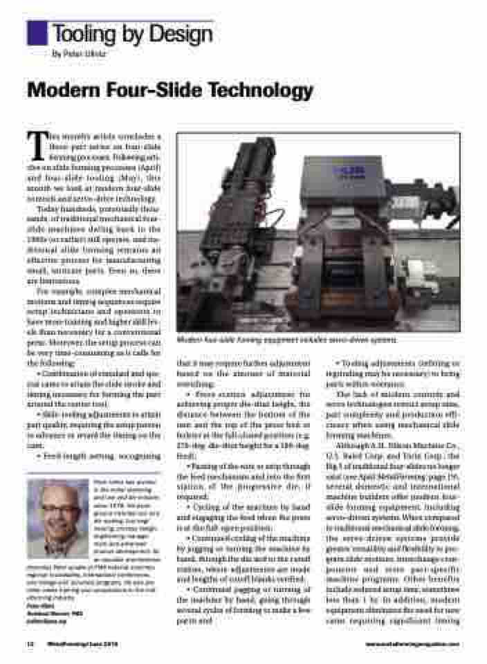

Modern four-siide forming equipment includes servo-driven systems.
