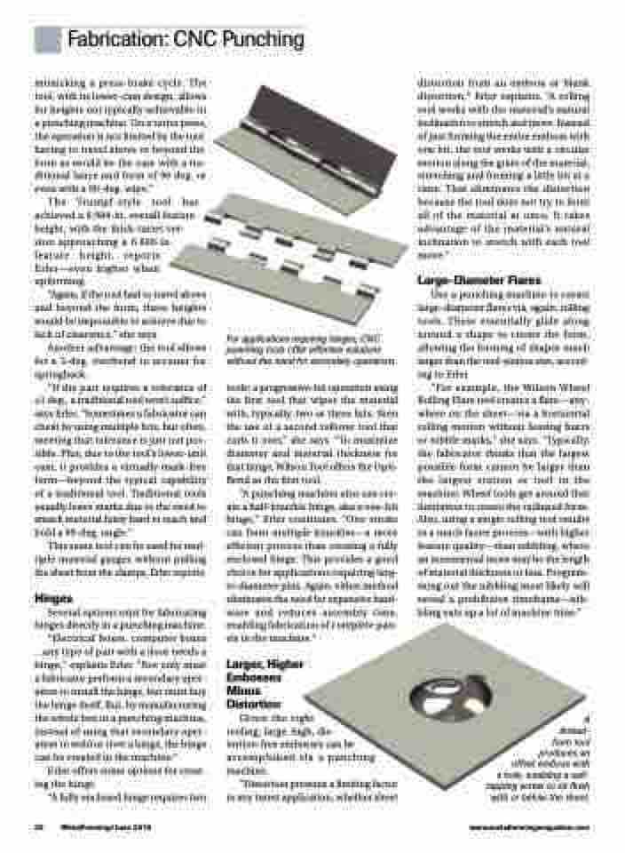

Hinges
Several options exist for fabricating hinges directly in a punching machine. “Electrical boxes, computer boxes ...any type of part with a door needs a hinge,” explains Erler. “Not only must a fabricator perform a secondary oper- ation to install the hinge, but must buy the hinge itself. But, by manufacturing the whole box in a punching machine, instead of using that secondary oper- ation to weld or rivet a hinge, the hinge
can be created in the machine.”
Erler offers some options for creat-
ing the hinge.
“A fully enclosed hinge requires two
For applications requiring hinges, CNC punching tools offer effective solutions without the need for secondary operations.
tools: a progressive-hit operation using the first tool that wipes the material with, typically, two or three hits, then the use of a second rollover tool that curls it over,” she says. “To maximize diameter and material thickness for that hinge, Wilson Tool offers the Opti- Bend as the first tool.
“A punching machine also can cre- ate a half-knuckle hinge, aka a one-hit hinge,” Erler continues. “One stroke can form multiple knuckles—a more efficient process than creating a fully enclosed hinge. This provides a good choice for applications requiring larg- er-diameter pins. Again, either method eliminates the need for expensive hard- ware and reduces assembly time, enabling fabrication of complete pan- els in the machine.”

A thread- form tool produces an offset emboss with a hole, enabling a self- tapping screw to sit flush with or below the sheet.
