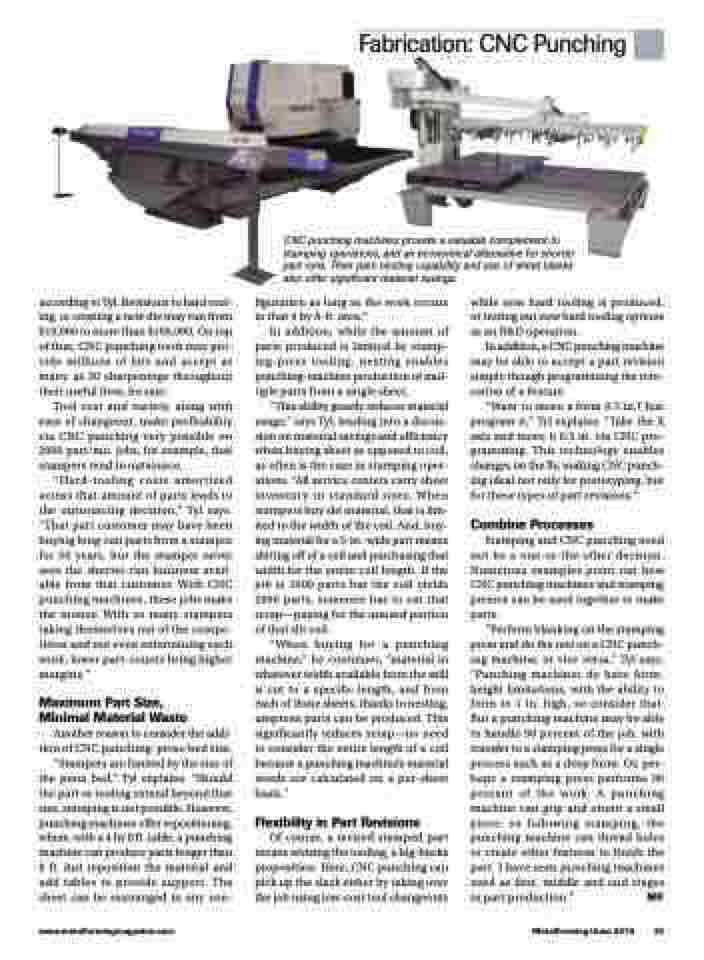

Fabrication: CNC Punching
 CNC punching machines provide a valuable complement to stamping operations, and an economical alternative for shorter part runs. Their part-nesting capability and use of sheet blanks also offer significant material savings.
