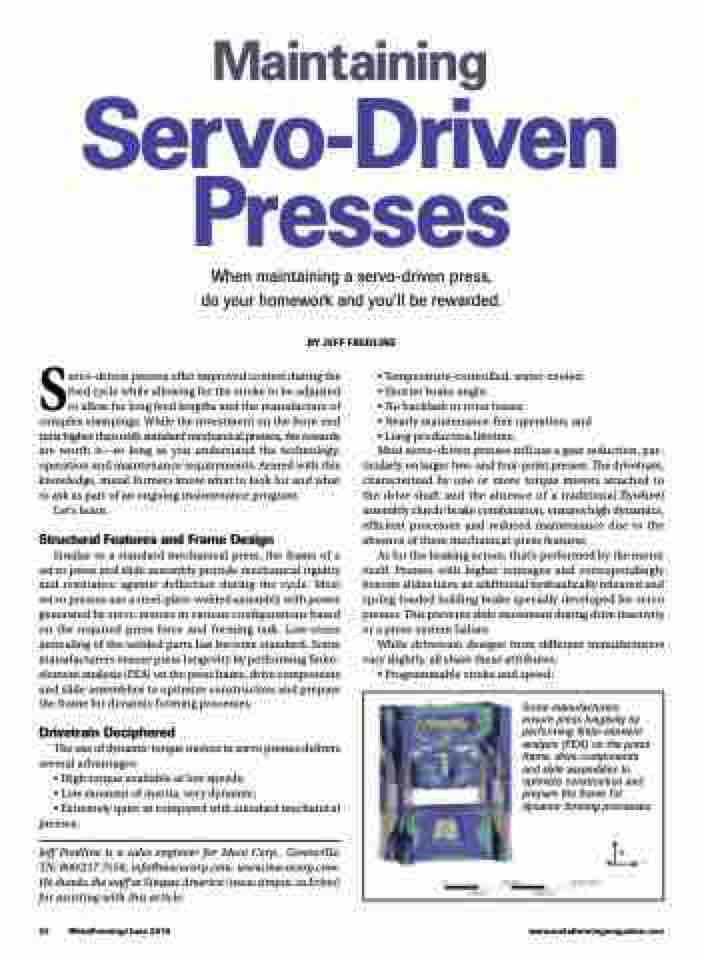

Similar to a standard mechanical press, the frame of a servo press and slide assembly provide mechanical rigidity and resistance against deflection during the cycle. Most servo presses use a steel-plate-welded assembly with power generated by servo motors in various configurations based on the required press force and forming task. Low-stress annealing of the welded parts has become standard. Some manufacturers ensure press longevity by performing finite- element analysis (FEA) on the press frame, drive components and slide assemblies to optimize construction and prepare the frame for dynamic forming processes.

 Some manufacturers ensure press longevity by performing finite-element analysis (FEA) on the press frame, drive components and slide assemblies to optimize construction and prepare the frame for dynamic forming processes.
