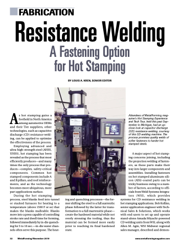

Attendees of MetalForming mag- azine’s Hot Stamping Experience and Tech Tour, held this past Sep- tember in Michigan, had an up- close look at capacitor discharge (CD) resistance welding, courtesy of this CD welding machine. The process promises quality welds of softer fasteners to harder hot stamped steels.
A major aspect of hot stamp- ing concerns joining, including the projection welding of fasten- ers, as these parts make their way into larger components and assemblies. Installing fasteners on hot stamped aluminum-sili- con (AlSi)-coated parts can be tricky business owing to a num- ber of factors, according to offi- cials from Weld Systems Integra- tors ( WSI), which provides
systems for CD resistance welding in hot stamping applications. Bob Kollins, senior application engineer with Tech- nical Sales & Solutions, which works with end-users to set up and operate stand-alone Amada Miyachi-powered CD welding units from WSI, along with Allen M. Agin, WSI Midwest regional sales manager, described and demon-
