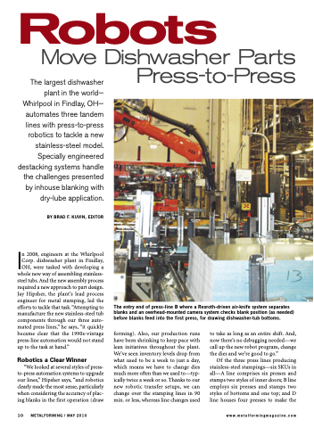

The entry end of press-line B where a Rexroth-driven air-knife system separates blanks and an overhead-mounted camera system checks blank position (as needed) before blanks feed into the first press, for drawing dishwasher-tub bottoms.
