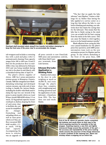

       Overhead shelf-mounted robots along B line transfer tub-bottom stampings to keep the front area of the press clear to accommodate die changes.

 End of line B, where an operator stacks completed tub bottoms and sends them on their way to the clinch-seaming machine for assembly to the tub wrapper. Seaming requires a very thin and tightly toleranced flange around the perimeter of the part — the accuracy and repeatability of the press-loading robots ensures the precision of this flange dimension to avoid a problem at the seaming line, where one misstep means scrapping out an entire tub.
