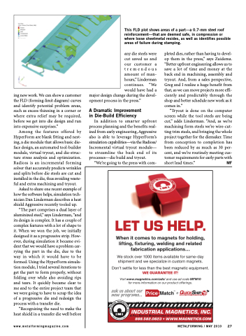

 ing new work. We can show a customer the FLD (forming-limit diagram) curves and identify potential problem areas, such as excess thinning in a corner or where extra relief may be required, before we get into die design and run into expensive surprises.”

Asked to share one recent example of how the software helps, simulation tech- nician Dan Linderman describes a heat shield Aggressive recently tooled up.
“The part comprises a dual layer of aluminized steel,” says Linderman, “and its design is complex. It has a couple of complex features with a lot of shape to it. When we won the job, we initially designed it as a progressive strip. How- ever, during simulation it became evi- dent that we would have a problem car- rying the part in the die, due to the way in which it would have to be formed. Using the HyperForm simula- tion module, I tried several iterations to get the part to form properly, without folding over while also avoiding rips and tears. It quickly became clear to me and to the entire project team that we were going to have to scrap the idea of a progressive die and redesign the process with a transfer die.
“Recognizing the need to make the heat shield in a transfer die well before
any die steels were cut saved us and our customer a tremendous amount of man- hours,” Linderman continues. “We would have had a
major design change during the devel- opment process in the press.”

This FLD plot shows areas of a part—a 0.7-mm steel roof reinforcement—that are deemed safe, in compression or where loose sheetmetal resides, as well as identifies possible areas of failure during stamping.
