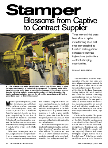

 A 12-in. alligator-style peeler feeds Hickory Springs’ new 110-ton press, to allow for hands-free threading of particularly thick material. The two-axis peeler table has a telescoping peeler blade to reach the leading edge of the coil, and an upper dekinker table that includes a motorized threading roll. During threading, the leading coil edge is pinched between the roll and the peeler table, and then the peeler table lowers to dekink the material.

Also critical to its successful imple- mentation of the new lines was a new 12-in. alligator-style peeler that feeds the 110-ton press, to allow for hands-free threading of particularly thick materi- al. Supplied by Coe Press Equipment, Sterling Heights, MI, which modeled the device after similar technology developed several years ago for its large- capacity machines, the new peeler- dekinker provides hands-free motor- ized threading capability for users of small and mid-sized straighteners. “It allows us to thread up a new coil of that heavy stock in less than 5 min.,” says Williams.
