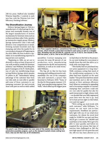

 200-ton press. Stafford also installed Wintriss SmartPac 2 controls to each new line, with the Wintriss Lets Line Efficiency Tracking Software.

Coe Press supplied identical, conventional feed lines for the 200- and 600-ton presses, which include a servo feed mounted to each press as well as a straight- ener, threading reel and 20,000-lb.-capacity coil car. A 42-in. line mounts to the 600-ton press, a 36-in. line to the 200-ton press.
 The plant’s new 200-ton press line runs some of the smaller dies needed for its automotive-assembly program, such as the stamped brackets shown exiting here from a two-out die that runs at 50 strokes/min.
